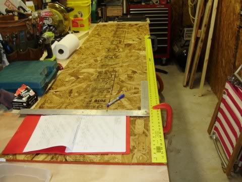

Laying out panels with a six foot straight edge and square

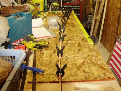

Clamped a .25 inch strip of wood to nails at layed out points

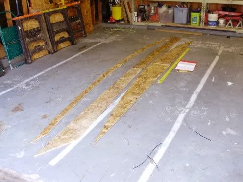

Cut out panels before sanding the edges to size

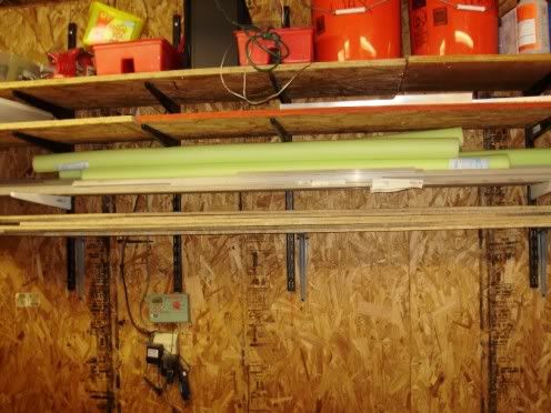

panels stored on bottom shelf
