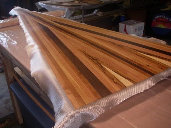

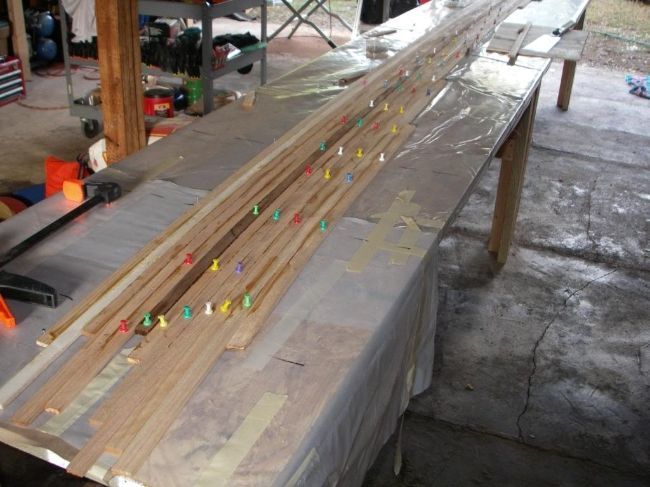

Fredrik, I have made several boats this way, and yes they do stand up to wear and tear over time. When gassed inside and out they are extremely tough. Tip..no matter how meticulous you are gluing the panels up on the bench, it's virtually impossible to get them perfectly flat, so I cut my strips slightly thicker than required then run them through the planer when glue up is done, saves a lot of sanding.
I've also glassed the inside of my panels before assembling them, far easier on the bench, with no problems in assembly.
That's great! Thank you for explaining the procedure and saving me some time!
My plan was to edge-glue with titebond, sand excess glue from the face of the panel, sheath the backside of panel with glass and then run it a pass through the sander to get to the final dimensions. I guess that is more or less exactly as you have done...
/Fredrik

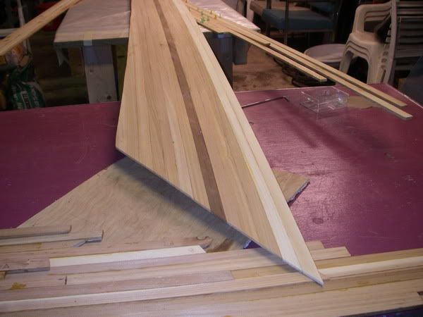

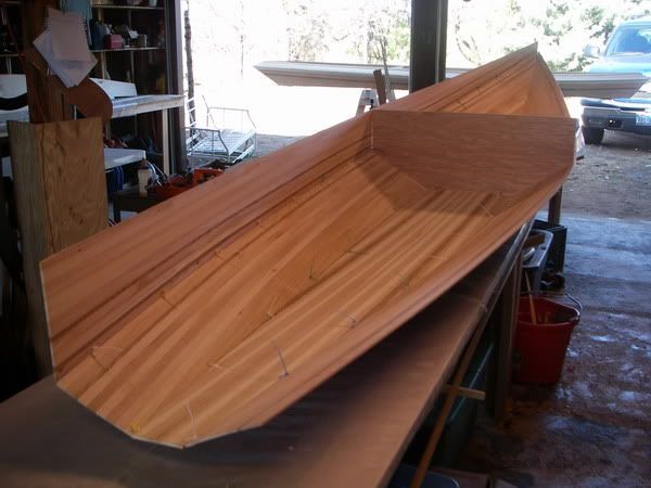

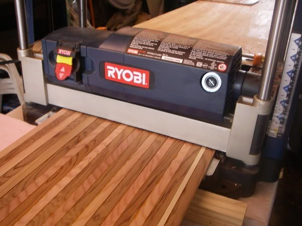

After edge gluing, I run both sides through planer, no sanding. Planer will give you a nice finish plus all panels will be the same thickness ( remember I started with slightly thicker panels/strips for this reason) then glass the insides.
MM
Panel cut to shape and planed ready for glass, inside only

Very nice work - handy planer you've got! How wide is it?

Fredrik
Forgot to mention my planer max width is 13 inches.
Just reread your initial post, spruce will be great for a kayak, probably better than western red cedar, I wanted Spruce for the mast's on my last build but nor readily available to me and to expensive to ship, also I have used Titebond II on my kayaks with good results, used Titebond III on the sailboat due to heavier stress. These are both great for our applications.
