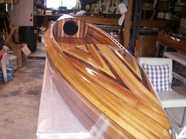

The core-sound looks marvellous. Very classic! Not familiar with the design - did you build it as a SS&G? 7 months is good! I think my cutter will take at least 5 years.

agreed, I chose this design due to it's success rate in the Everglades challenge ( a US type raid).
7 months due to the fact I'm retired and now have the time, the main hull is stitch & glue.

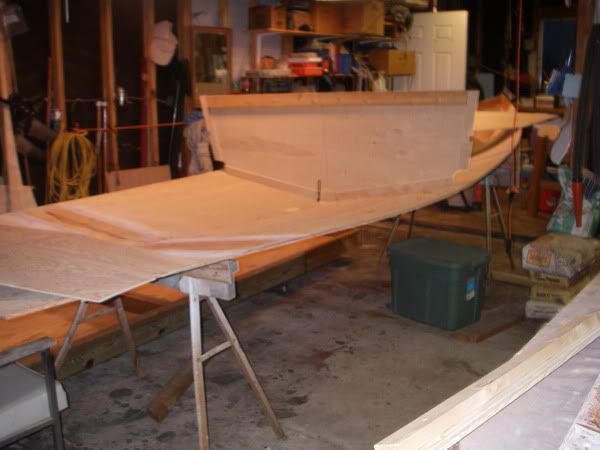

Those of you that have built SS&G versions of these boats - how did you modify the plans to allow one step gluing full-size panels? I would like to avoid the scarf in the middle of the panel. I believe one way is to make a scarfed full-size pattern and use that as a guide for the gluing of the full length strips. Any another way to do it?

As to gluing full size panels, I made templates from real cheap plywood,to verify diamentions, then simply traced them onto painters paper on my 16' x 2' work bench, covered that with clear plastic, then glued up the individual strips staggering the scarfs as I went (panels were made oversize to allow for errors) then after glue up traced the templates back to the panel and cut to size. I hope that all makes sense to you. ?

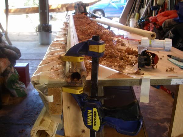

I'd like to make some birdsmouth paddle shaft's and mast's using spruce.

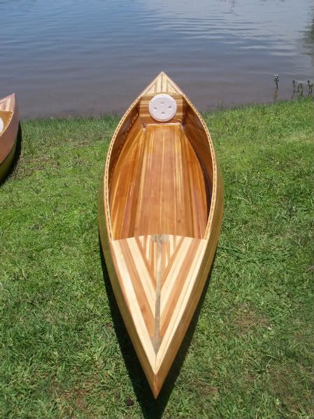

Iv'e done a few of Matts boats, the Wye 13-6,
