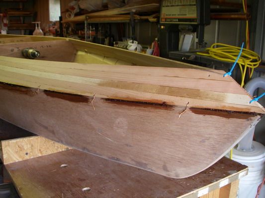

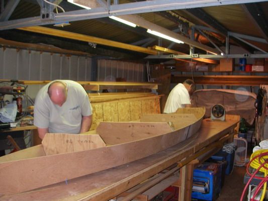

update on the 15-32[url][URL=http://s469.photobucket.com/user/makenmend/media/IMGP5048_resize.jpg.html]Image[/url][/url]
My friends assembly to the 3D stage
[url][URL=http://s469.photobucket.com/user/makenmend/media/IMGP5051_resize.jpg.html]Image[/url][/url]
All wired up
[url][URL=http://s469.photobucket.com/user/makenmend/media/IMGP5057_resize.jpg.html]Image[/url][/url]
filleted and taped.

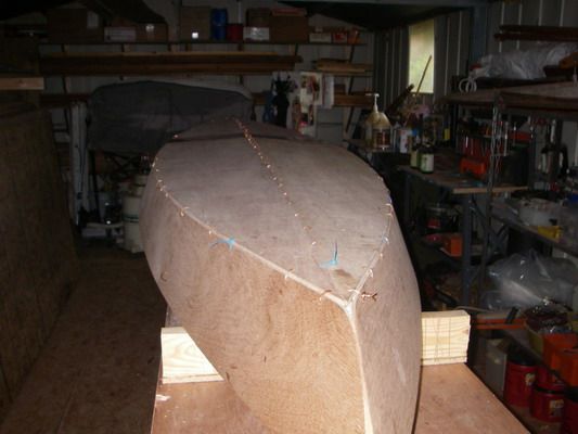

top panel glued up
[url][URL=http://s469.photobucket.com/user/makenmend/media/IMGP5038_resize.jpg.html]Image[/url][/url]
stitched in place
[url][[URL=http://s469.photobucket.com/user/makenmend/media/dougsboat001_resize.jpg.html]Image[/url]/url]
and tacked on
[url][URL=http://s469.photobucket.com/user/makenmend/media/dougsboat002_resize.jpg.html]Image[/url][/url]
The inner fillets are done, now onto competing and cleaning up all seams, assembling bulheads and decks.

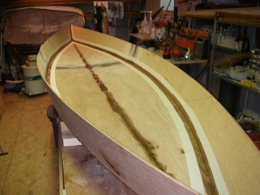

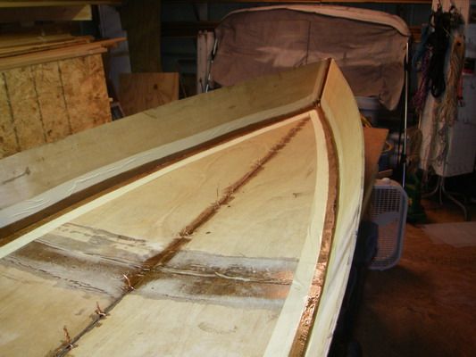

MM- great to see your pics - looks nice and clean. Can you explain your technique of filleting the inside? It looks like you took the frames out and then put them back in for the upper panels. Did you fillet between the stations and then take them out? thanks
 Post subject: Re: starting a TV 32-15
PostPosted: Tue Jun 24, 2014 10:44 am
Joined: Tue Nov 03, 2009 2:29 pm
Posts: 179
Location: Longview East Texas

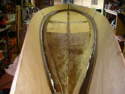

Yes I tack glue between the frames, allow to set up well, remove the temp frames,mask off the sides and run a good fillet the full length [url][URL=http://s469.photobucket.com/user/makenmend/media/IMGP5059_resize.jpg.html]Image[/url][/url].
I then allow 3-4 hours for the goopie to start kicking, then I've found a can smooth the fillets with a moist finger (saves sanding) remove the masking tape. lay the 3'' tape and wet out with epoxy. Done. [url][URL=http://s469.photobucket.com/user/makenmend/media/IMGP5062_resize.jpg.html]Image[/url][/url]

when this is set up I come back with a scraper to fair the tape edges then fill the weave as normal.
[url][URL=http://s469.photobucket.com/user/makenmend/media/dougsboat008_resize.jpg.html]Image[/url][/url]
this tool from http://www.duckworksmagazine.com/ is also a big time saver over sanding ''Bahco Carbide Scraper & Inserts''
MM

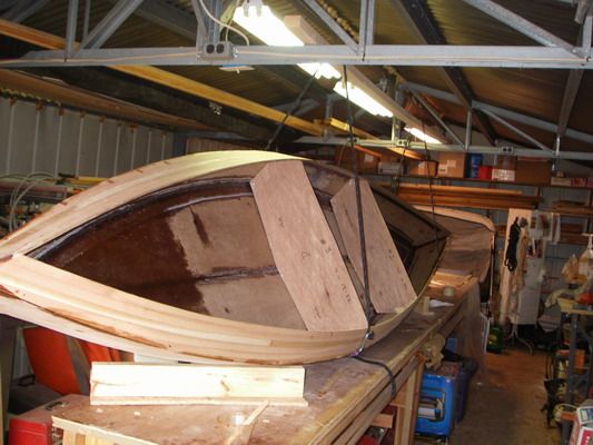

I then reinstalled the temp frames to stitch on the upper sides. tack the outer seams, let set up, flip the boat on one side to run inner fillets, then the other side next day, I removed the 1st and 4th frames so I could run almost full fillets. [url][/[URL=http://s469.photobucket.com/user/makenmend/media/dougsboat011_resize.jpg.html]Image[/url]url]

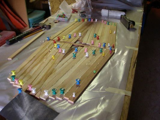

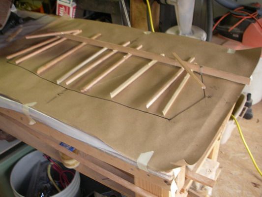

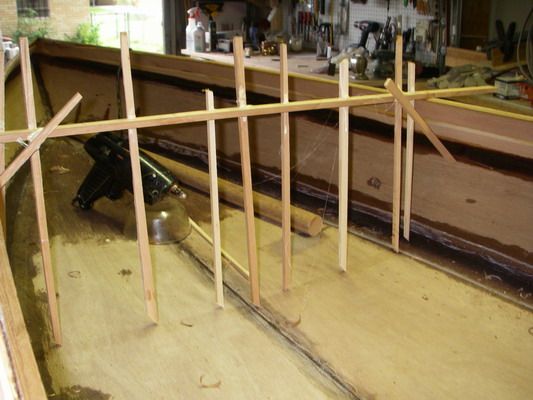

So here's a little update.[url][URL=http://s469.photobucket.com/user/makenmend/media/IMGP5137_resize.jpg.html]Image[/url][/url]
Taking off points for bulkhead template.
[url][URL=http://s469.photobucket.com/user/makenmend/media/IMGP5138_resize.jpg.html]Image[/url][/url]
Transfer points to paper
[url][URL=http://s469.photobucket.com/user/makenmend/media/IMGP5147_resize.jpg.html]Image[/url][/url]
Gluing up bulkhead from template.

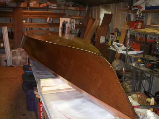

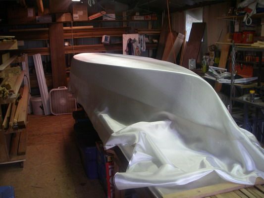

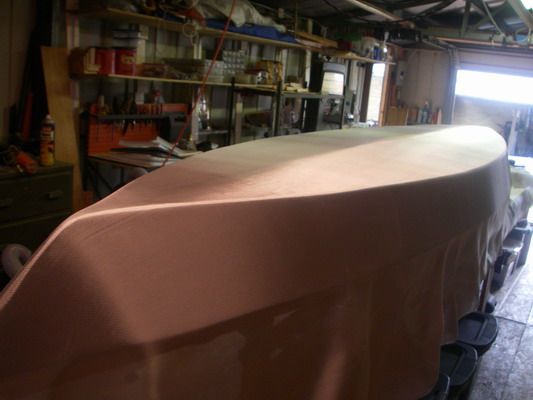

[url][URL=http://s469.photobucket.com/user/makenmend/media/IMGP5224_resize.jpg.html]Image[/url][/url]
setting up to glass exterior.
[url][URL=http://s469.photobucket.com/user/makenmend/media/IMGP5223_resize.jpg.html]Image[/url][/url]
All wet out, 1 coat.
[url][URL=http://s469.photobucket.com/user/makenmend/media/IMGP5225_resize.jpg.html]Image[/url][/url]
2 fill coats for now, will be graphite coating bottom at later stage.
