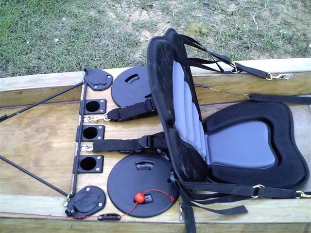

the holes in the mid deck, the two big ones are gor round hatches. The other 5 are for rod holders. there will be two more adjustable ones mounted on the cockpit side decks.
the five benind me are configured as follows.
Port & starboard are angled out and back at 45 degrees for trolling for pelagics. the three middle vertical ones are for landing net, gaff and donger/light.
the two front holders will be for trolling in estuaries for smaller fish.
next week hopefully.

The round hatches are also the right size to sit a small bait bucket in for when I am live baiting. I use a small crustecean here we call a yabbie. they are a little like a prawn (shrimp?) Outstanding bait and anything that swims will eat em.

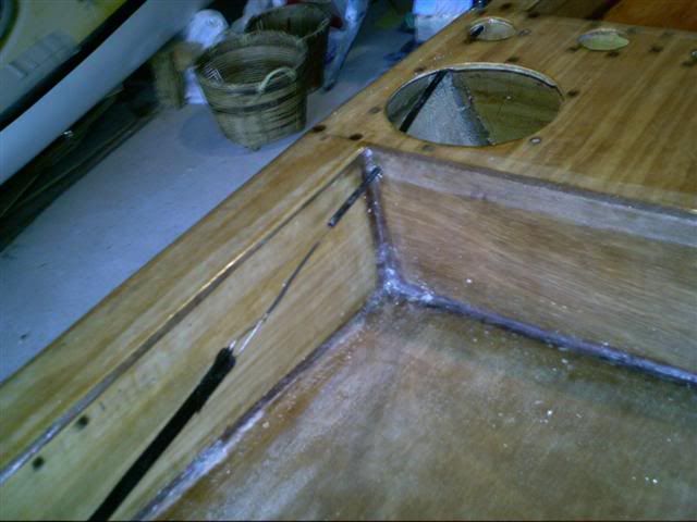

I struck a problem today. My resin has suddenly turned real slow to go off and as I was screeding it off, it has turned a milky colour in patches. mainly in corners. does anybody know what might cause this?
Anyway, I got the top coat of resin on the topside today and have started fitting her out. will finish putting the fitting on tonight, (if the resin ever drys) and turn her over 7 put one more coat on the bottom.

Milky tinge
rudder & controls are fitted
cockpit livewell/cooler hatch is on
Nice & shiny
Milky tinge

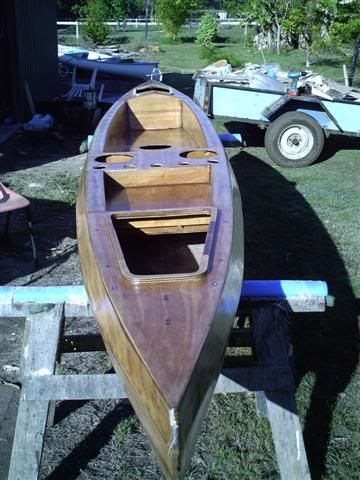

Centre Deck
Bow Shot
Seat Set up
Stern Shot
General
Thanks for the tips DM they could explain a lot. The measures are right but the weather has been real strange here these past few days. We had a hail storm materialize out of nowhere after the last resin coat went on but before it went off.
Such storms are unheard of here during winter/spring. Also the temp has turned suddenly cool and very damp. again unheard of here. typically, our winters are relatively mild with the weather very dry and the days sunny.
I am waiting for the resin to cure real hard now before I attempt to sand out resin runs etc. While waiting, have installed the fittings
I'm real pleased with the final result.
Centre Deck
Bow Shot
Seat Set up
Stern Shot
General
