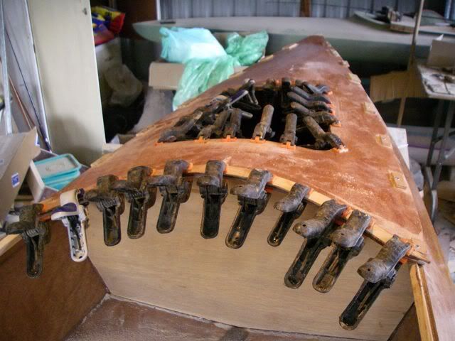

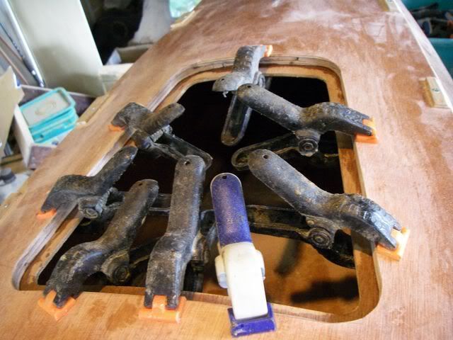

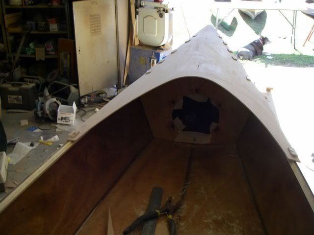

Not much to report,
Playing with hatches and such. I call em fiddly bits. Things where a lot of time can be put in for little result to be seen.
Cut the hole in the back deck for the hatch, made up some layers for the hatch coaming. Started glueing them in.
Also doing a sort of mini coaming across the front of the rear deck.

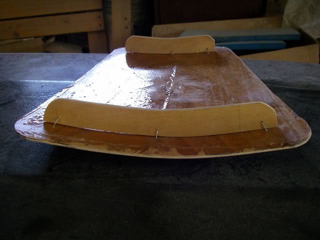

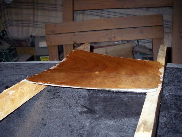

When I cut the hole for the hatch, I half expected (hoped) the resin on top would have held it pretty close to shape. Not to be. It went allmost flat as soon as the tension was released.

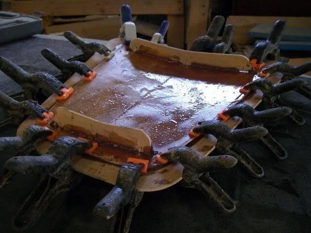

Reverted back to Matt's idea for the decks on another Kayak and made female frames to hold the hatch lid in shape while I applied resin and fibre - glass to the concave surface of the inside. Again, Matt was right and I was wrong.

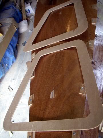

While I was playing with the saw did a couple of these.
Rounded decks are a PITA!!

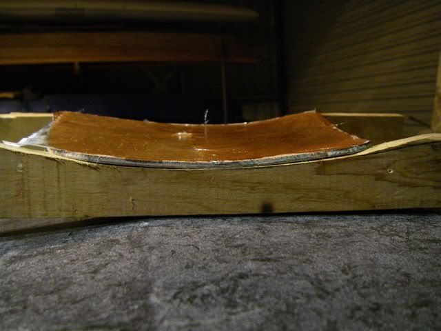

Hatch lid was still not curved enough this morning to match the deck.

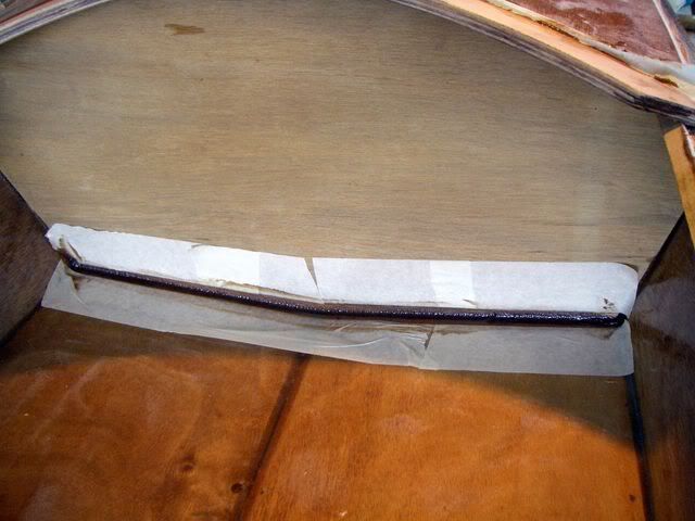

Hatch lid, try 3.
Glued the sealing lip on while I was at it.
And the inside seal lip on the hatch hole.
Did a lil filleting with left over wood flour,
Hatch lid, try 3.

Mick....
I haven't done a rounded hatch but am thinking that if the deck was positioned where you want it. Then glassed on the inside and outside , the way you would do a solid deck.
Now drill 5 or 6 ... 1/16th holes in a line and with a fine pointed saw cut (the Previousley marked ) deck out. Now attach the sealing lip to the inside /under side of the deck and the hatch cover would hold it's shape and fit like a glove.
Chuck.
Chuck.
- Site Admin
- Posts: 4916
- Joined: Fri Jun 18, 2004 8:14 pm
- Type of boat I like: Wooden
- Location: Greensboro, NC
I tried to make a rounded hatch without any internal stiffeners. My idea was to make the lip a little smaller and forced the hatch lid to bend around it. Didn't work consistently.
I were to do it again, I'd try some kerf slits to make the plywood hatch cover more flexible. Then maybe the hatch would stay bent.
But I personally like the stiffeners because you can drill a hole through them and have a spot to lash a hatch-keeper bungee.
Another alternative would be to make the hatch cover out of strips of ply or lumber. But that might look funny.
