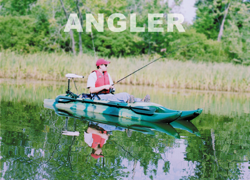

There's a few plastic boats of this nature out there like this except more of pontoon hulls.
Kiwi Kayak has this one
There's another brand out there that I tried. My PERSONAL OPINION about it is that it's unsafe. So I won't mention the brand or the website or allow it to be mentioned in this forum. Mom said if you can't say something nice....
Anyway, I've tinkered around in my head with stitch and glue versions of a mini catamaran boat (canoe) but it's such a radical concept, I'd be afraid to publish plans without a prototype being made first.
One thing about an inverted V hull in a canoe that worries me is this: Imagine paddling it into some mud or silt: You'd slice right in and get stuck!
But it actually would not be a hard canoe to build.
