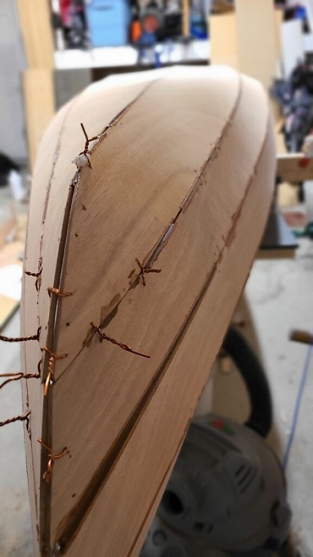

Got all the panels stitched up. Somehow forgot to stitch in the bow jig which I had asked Matt about in the questions forum.
The bow wasn't the greatest, so I unstitched it and put the jig in. It helped the shape a bit, it still wasn't perfect but good enough for me.

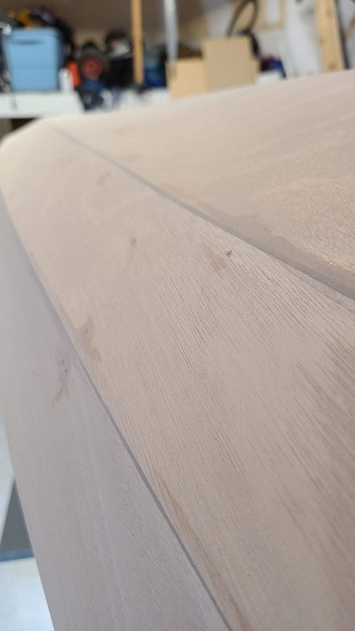

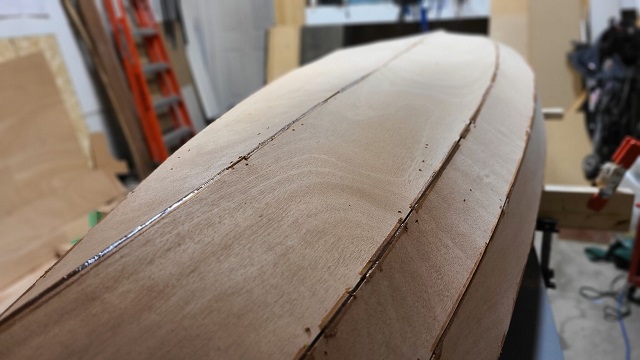

Next came sanding of the fillets down. Didn't realize how smooth everything was going to feel
I did 60 grit by hand as I wanted to work out the hull chines and was scared I was going to blow through the plywood veneer with a ROS

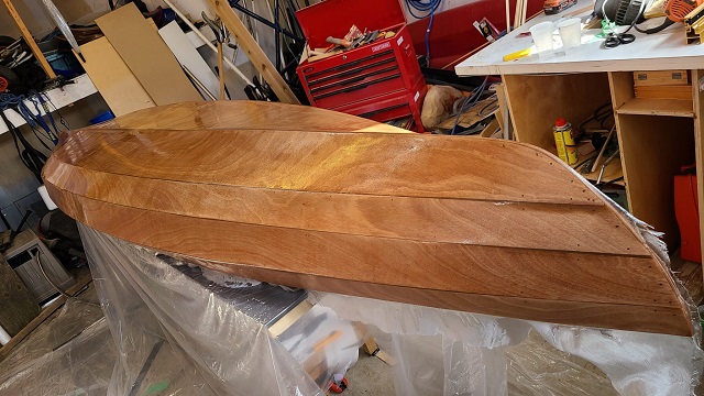

Fiberglass the hull. Watched so many videos on this. I gotta say this, its nowhere as easy as the videos look.
The way Panel A has an inverse incline when upside down means epoxy wants to drip off the edge of panel B. Seeing panel A clearly was a shore because it was in the shadow of my light. Also the kayak was way too close to the table and plastic sheets I used, so eventually the epoxy started sticking to the plastic which wasn't too bad, except than when I moved or accidently pulled on the plastic a bit the plastic would pull the fiberglass off the edge.
Saturating and the first fill coat went on fairly well. The 2nd fill coat are where things badly went wrong. Maybe I was a bit tired or too over confident, or switching to the roll on and tip with a brush method messed me up. But its extremely hard to distinguish fresh epoxy from hardened epoxy. The Raka I used is also very thin. I've since learned that you have to be very careful with it, even though it looks good when you walk away, 30 mins later it can develop runs. And runs I have! There must be a whole section I didn't tip off or applied way too much. Hull panels A/B are the worst.

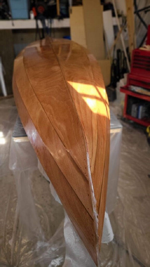

Where its mostly flatter like panel D there are some beautiful sections. Hoping with a lot of sanding the whole thing comes out more like panel D!

Funny thing is, now that I've finished sanding, man there's so many drips that had to be sanded out!
